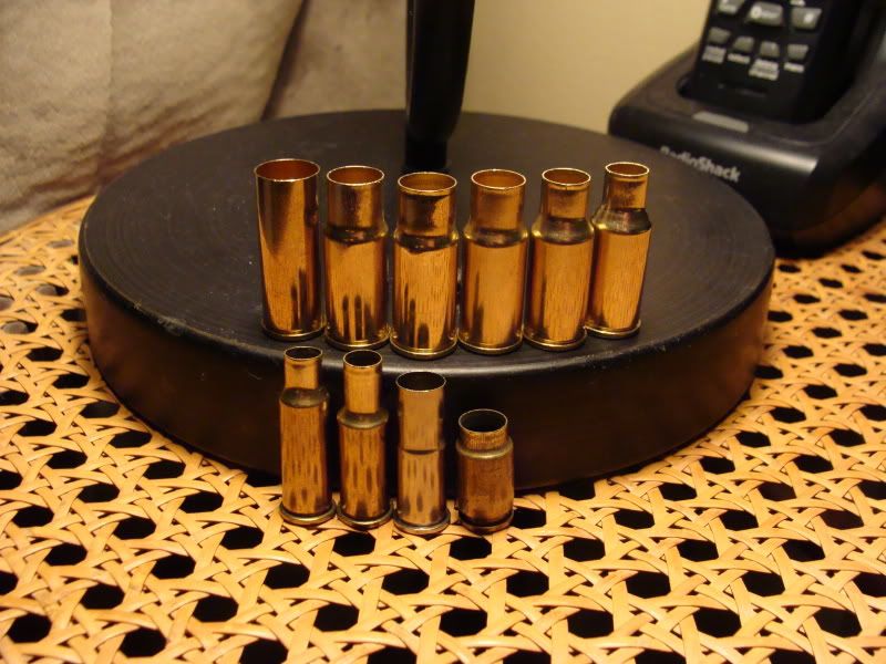

For example, yesterday I learned that .35 Whelen is just a 30-06 case "necked up."
Does that mean that the 30-06 casing is literally stretched out?  Or do they manufacture a whole new casing?
Basically, I'm trying to ask how necking up or down works... :coffee

    They stretch it out very carefully using a die.  But this isn't true of all wildcats.  If the size change is too extreme, stretching isn't an option and creating a new case is in order.
    Sometimes a wildcater will cut a very long case at the shoulder and then neck that down to the desired size rather than necking UP another already shouldered case.
    -T.
    Another option in some cases (no pun intended ;D ) is getting virgin brass, brass that has been unformed from the factory.  So, straight wall .30-06 brass, do whatever you wish with it.

    All the above is correct, of course.  It gets rather involved when you make radical changes, but in the case of .35 Whelen and the like a case is simply run over a tapered expander and the case neck opened up like one would resize a ring.
    To neck down a case, the case is run into a die with a smaller neck.  You do this everytime you resize the neck when you reload, necking down is just more of the same.
    When you neck up or down, you also thin or thicken the case neck slightly.  Most wildcat chambers take this into account.  If you were to try to make .22-250 cases from 30-06 this would need to be addressed.  Fortunately, 22-250 cases are easy to buy.  Necking down cases also makes them longer.  A radical example:
    Factory cases are typically formed to be useful in the cartridge for which they are headstamped.  This isn't always the case, but 99%.  I've got cylindrical  brass from several manufacturers, but you mostly have to seek this out.

    There are other ways to make wildcat cases as well.  The original 445 supermag cases were 30-40 Krag rifle brass cut off and then reamed/bored to take .429" dia. 44 mag slugs.
