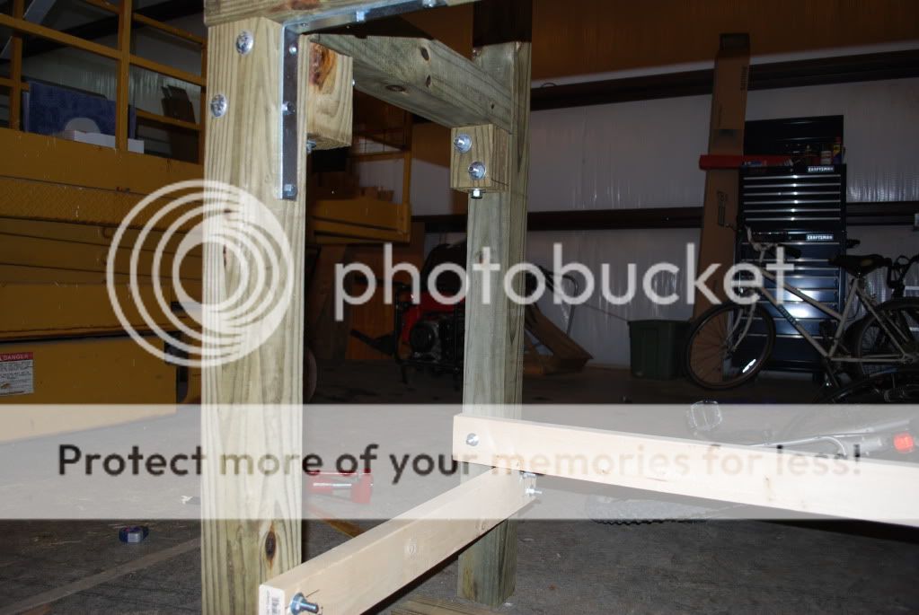

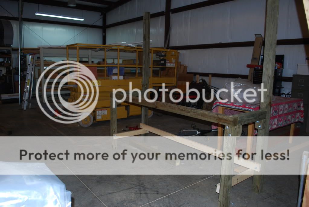

I am pretty excited about this, my first ACTUAL reloading bench/workbench for gun projects.

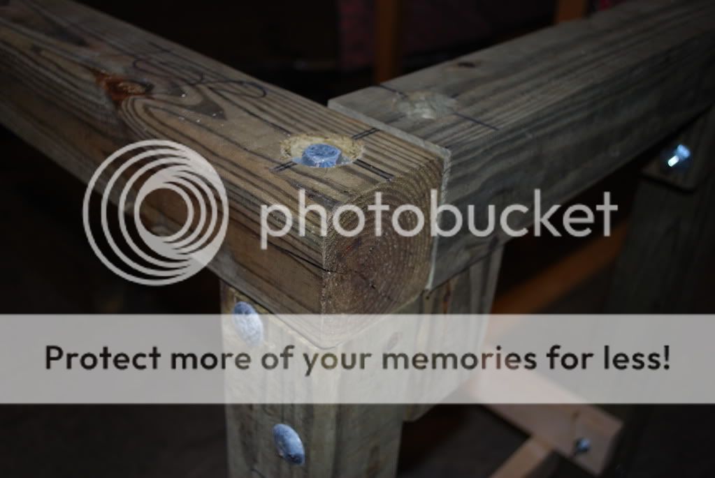

Here are a few pics of it so far, I have to put on one more 4x4, and the surface, after the liquid nails cures:
The frame is held togther by 1/2" carrige bolts, and 4 1/2"x8" lag screws.  It ain't going anywhere.  It is also going to be bolted to the back wall, right into the steel gerters... :devillol
There is going to be a sheet of OSB on the back of the thing, as a wall to prevent stuff from falling down.

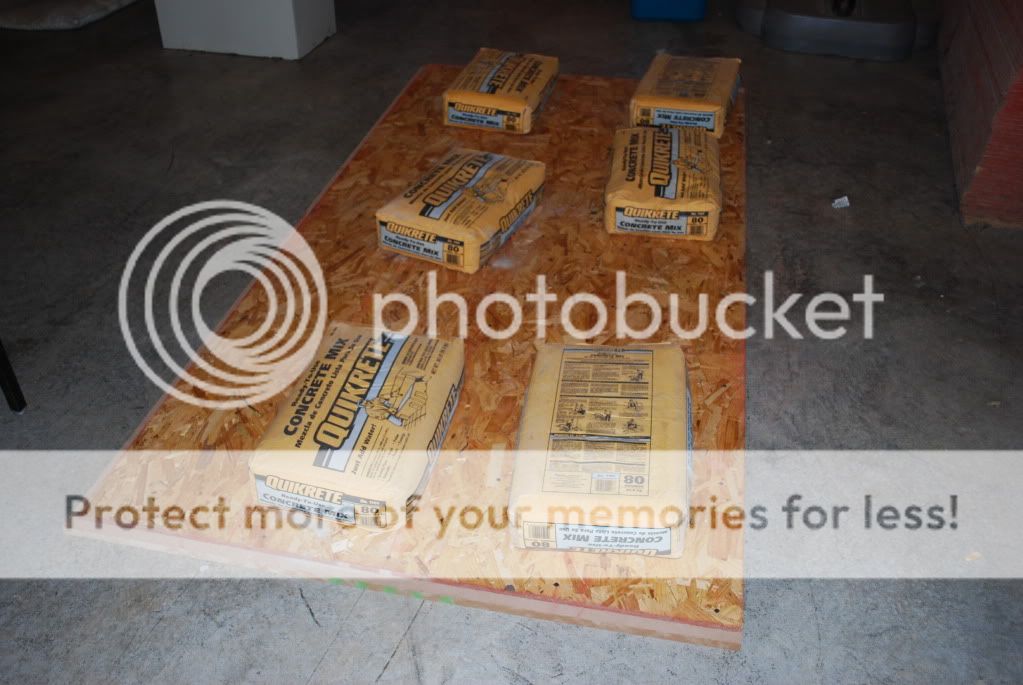

This is the tabletop surface, 23/32" polyboard laminated with 7/16" OSB, liquid nails and pre-drilled drywall screws hold them togther:
Comments and/or suggestions?

    « Reply #8 on: October 06, 2009, 10:26:27 pm »
    On the hair?  Yeah. just wait 'til you give yourself a good shove to go under a truck on a creeper and wrap the 'ol mullet up in the creeper wheel which slams your head into a concrete floor VERY hard before winding up in the wheel so tight you can't even move without scalping yourself.  Oh, and at this point you're pretty much under the truck, so standing up carefully to extricate yourself is a no-go.  Or so I hear anyway......
    On the bench-
    I LIKE those long braces under the top front.  That should control wobbling to a high degree.  What color is your working surface going to be?  I recommend white.  It helps with lighting, and makes it easy to see spilled powder, dropped primers, etc.  Is it going to be anchored to a wall in its permanent home?
