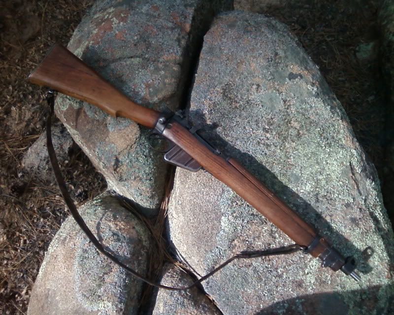

Here is the rifle as it currently looks:

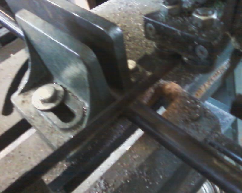

    Chopping the barrel in the bandsaw:

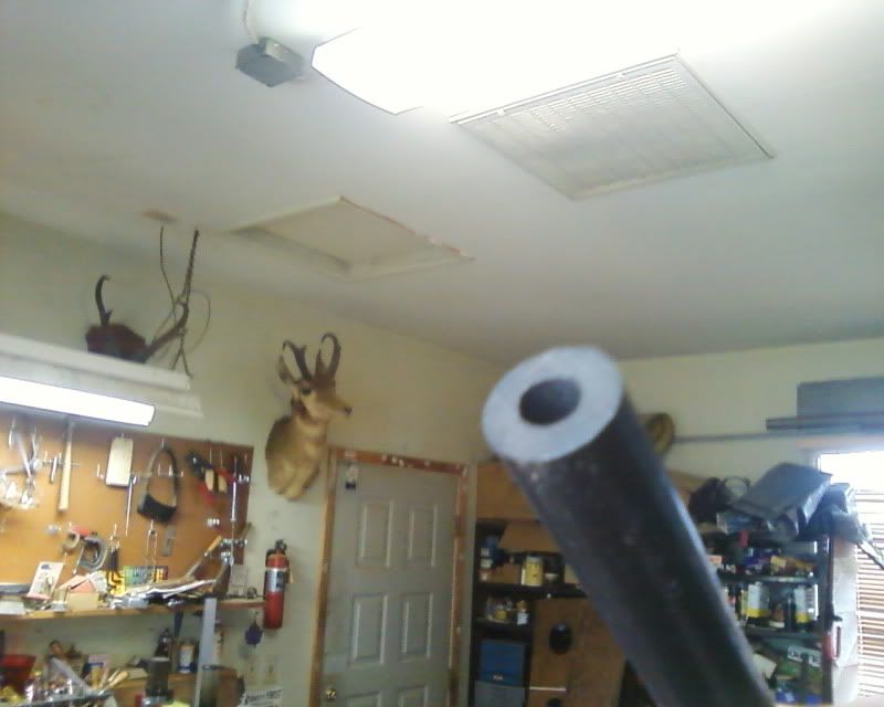

    Freshly hacked muzzle:

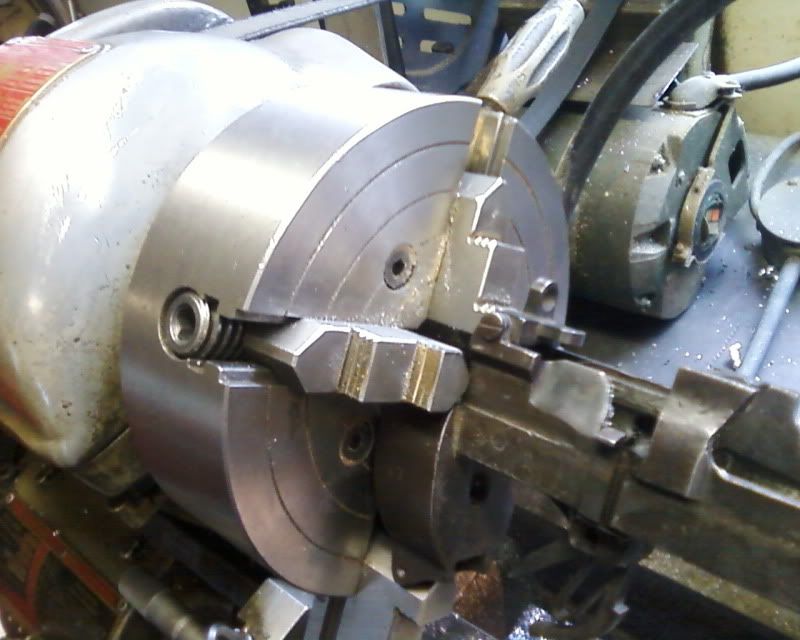

    The barrel wasn't long enough to stick through the chuck on my lathe and I didn't really want to get out the barrel vise and action wrench to try pulling off the barrel, so I stuck the receiver in a 4-jaw chuck. All four jaws are independently adjustable for holding odd shapes:

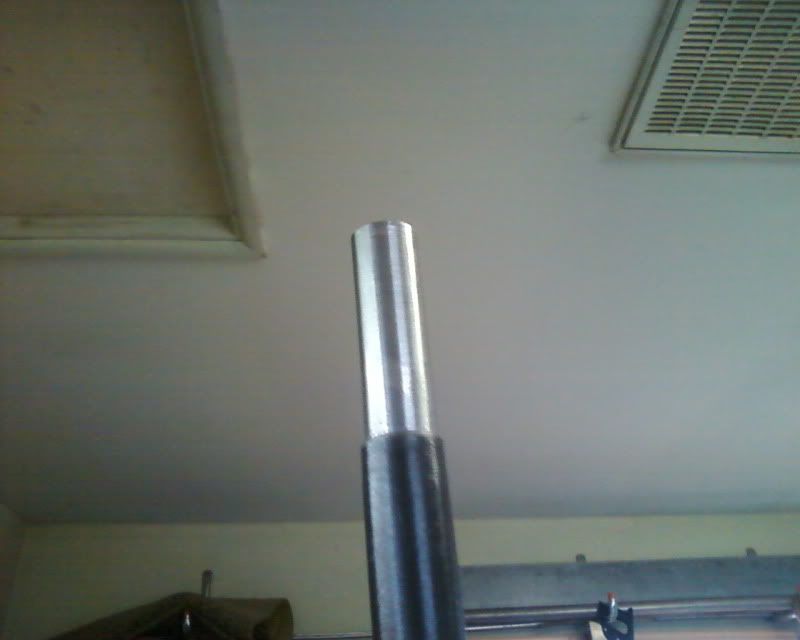

    Barrel crowned and profiled:

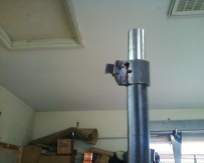

    Front sight in place:
    And the pic you have all been waiting for!:
