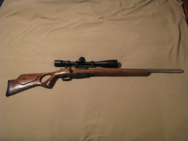

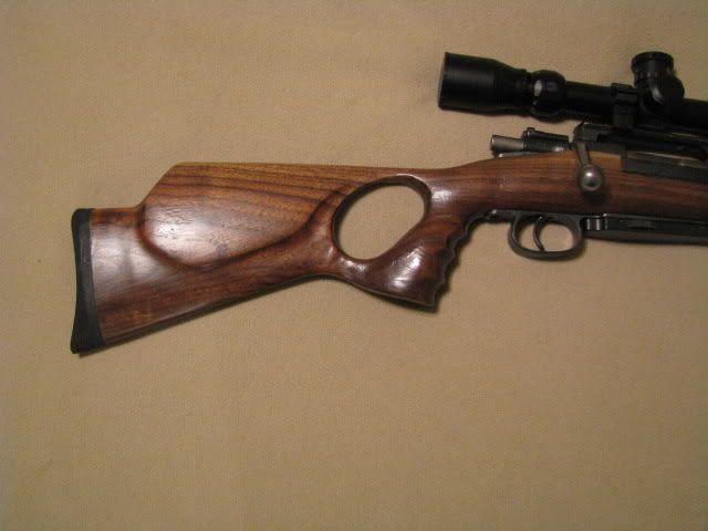

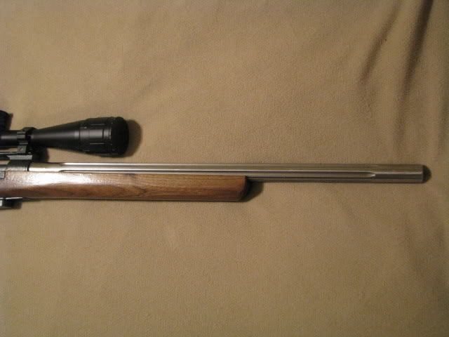

I was looking for a .223 rifle for varmint hunting and target shooting. I had my eyes set on either a Remington 700 SPS Varmint or a Savage 12 in .223. I wanted a bull barrel and a good action. I was watching gun broker and happened across this rifle. Its a small ring 1896 rechambered in .223, with a stainless fluted bull barrel, Gibbs drop magazine, Intergrated scope base, bent bolt, and a custom wood thumbhole stock.
Now I got the rifle for $286 shipped, which is a good bit for a small ring, but the custom barrel is $250 by itself. The barrel is ~22"

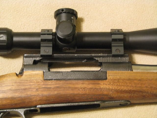

I mounted a BSA sweet 223 set for 55gr and It bore-sighted easy. I am not thrilled that the base is shimmed with beer can, but it works.
 Next I have a Boyd adjustable trigger with side safety and a cock on open kit that I am installing tomorrow (10/17) if all goes according to plan (Joker voice). I chose the side safety because the rifle has had the original disconnected as to not contact the scope. I will replace the end of the bolt with a cap at a later date to clean up the rifle. The receiver is finished in what appears to be Walmart grade 'Hammered Finish' Krylon.
The stock is a mottled color hardwood and it was broken in shipping at the top of the pistol grip. I spent 45 min at work digging up a bolt and fixing the stock (gotta love working at a pawn shop). I will end up fiber-glassing over the wood to both reinforce the broken section and to build up other thin areas as well as the nearly nonexistent and horribly attempted free-float handguard.

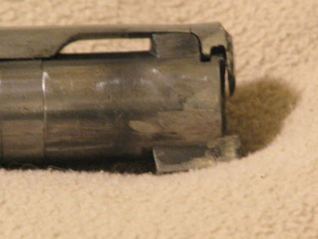

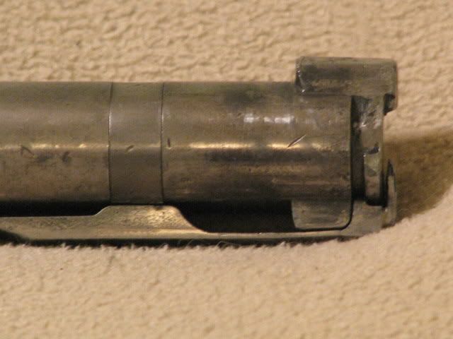

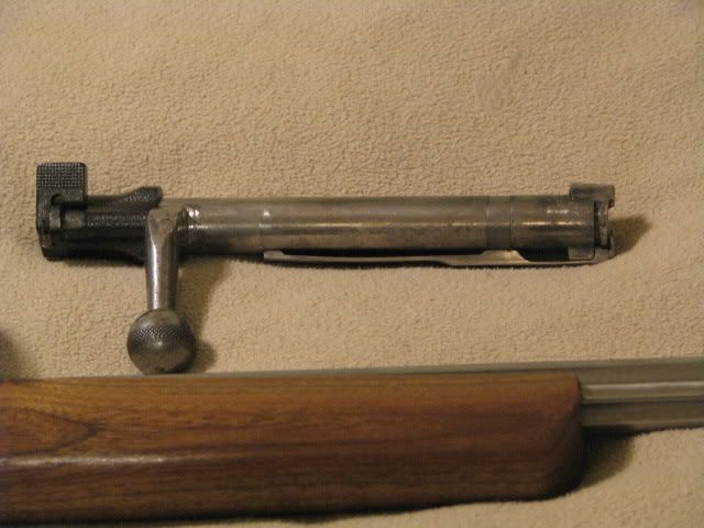

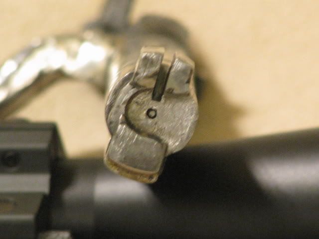

Next we look at the bolt. It looks like it was recut to fit the 223 casing, but since it feeds and extracts perfectly I am assuming this was done correctly when the barrel was threaded in. It does not appear to be lengthed.
If the weather here holds (its been raining on and off the last two weekend), I'll be able to give a decent range report on the rifle as it stands now. I'm hoping to get the trigger installed before then but it will require the stock to be cut and I'm not sure I'll have the time to get it fitted and get to the range in daylight with no rain. We shall see. Also I have to zero the scope and I picked some Hornady .223 55gr FMJ premium rounds for the job. I probably won't be shooting that all the time, but I figure I want the best zero I can get to start with.
I haven't fired a rifle (besides assault style rifles) in a while, so I hope to have a nice tight group to photograph and put in this thread, but that is for another day. Hopefully I get to take some coyotes with it in the near future though.  >:D

    Cool! I'll look forward to your report on how it shoots.
    Be careful when you cut the cocking ramp, it's easy to overdo and it would be a pain to duplicate all the work that's already gone into that bolt.

    So is this a total custom rifle?
    CaliforniaThere are many like it, but this one is mine.
    Thernlund
    • Posts: 14098
    Re: Custom small ring mauser
    « Reply #3 on: October 17, 2009, 02:03:57 AM »
    About as custom as it gets.
    Nice rifle!
    -T.
    Arizona  Arm yourself because no one else here will save you.  The odds will betray you, and I will replace you...

    The cool part about working where I work. I've been made good friends with a regular customer who works on nothing but mauser platform rifles. If it exists for a mauser, he has seen it or done it. Plus he has a full machine shop at his house and a hunting lease behind that, all within 15 mins of my house and 5 mins of my work. His next project is to cnc a 1911 from scratch on his equipment. I'd say he's crazy but he has done some miraculous things with old rifles and handguns. He has already offered to reimburse me for my rifle if I don't like how it shoots. Lol. He has even offered to replace it with a Savage or Remington, if he can find one for the same price.
    Sunday we take the rifle for a range trip and hopefully we can install the parts before we go. I'll keep things updated as best I can.
    Everything on the rifle has either been replaced or modified so technically yes. Lol
    Yeah, Perry (the aforementioned mauser nut) has a good bit of experience with these as well as a spare parts bin the size of an armory's. We'll probably practice the cut on a parts bolt first.

    Since it's an 1896 Mauser, it almost certainly started life as a Swedish military rifle in 6.5x55; either an M96 or M38 and made by either Carl Gustaf or Husqvarna. Edit: Whoops, missed jb83's post.
    Here is my Carl Gustaf '96:
    Cock-on-open, Douglas Barrel, bent bolt handle, Weaver mounts, mod. 70 style safety, Timney trigger, etc. Still in 6.5x55 Swede.

     There are some cautionary words about rechambering the small ring mausers for modern high pressure cartridges-
      Can't remember specifics though.
    • Posts: 12450
    « Reply #17 on: October 17, 2009, 02:50:02 PM »
    I've heard widely varied opinions on that. Some people say that they used softer steel and the lack of a safety lug makes them dangerous for anything but mild rounds, others say they hold up just as well as a 98. I'm not inclined to push my luck with one.
    Either way, .223 should be perfectly safe. It's a fairly high pressure round, but its small head diameter means it can't generate all that much bolt thrust relative to the rounds the action was designed for.
    My understanding is that .243 is about the hottest you would want to push a small ring, and even then only if it is in excellent shape.
    The .223 should be well within safe limits for overall operation. (I hope :hide) The majority of barrels manufactured for small rings support low pressure or small chambered barrels only.
