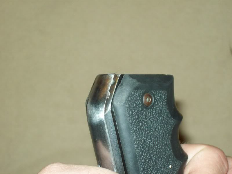

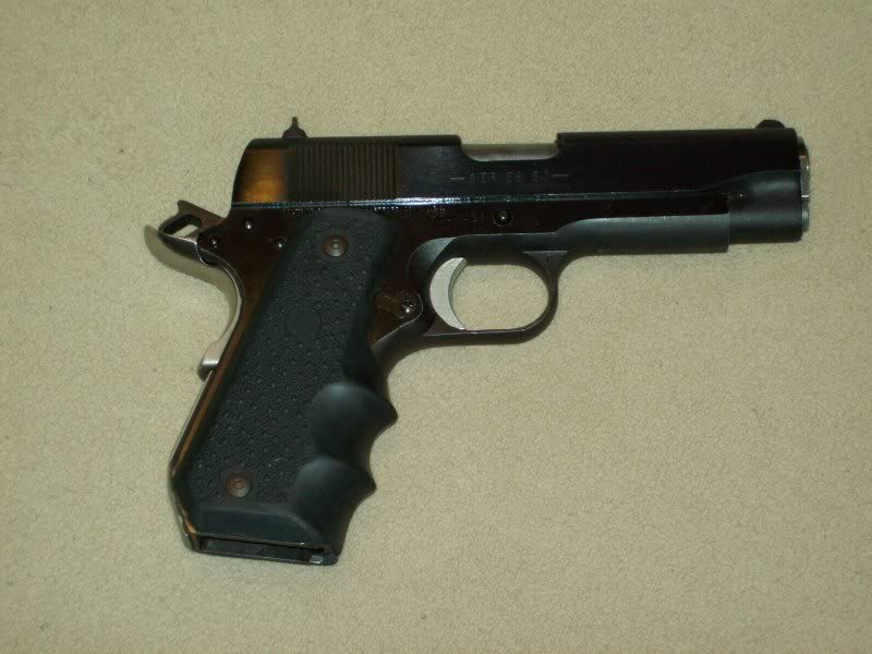

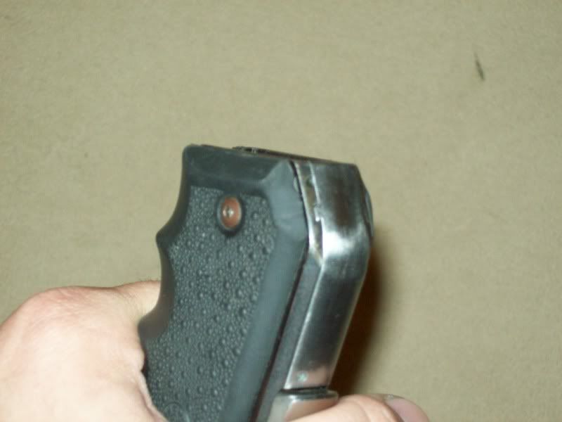

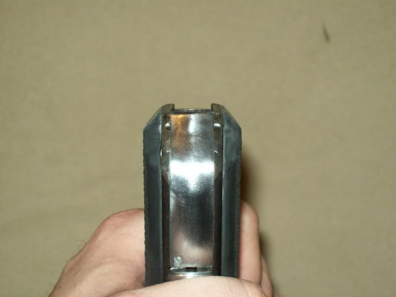

Well, I went to my local Cabela's and was drooling over the Kimber Super Carry 5" with the perfectly round radius-ed bobtail and alloy frame last weekend, so I looked and found the Super Carry plus (3" slide on Commander alloy frame with bobtail) and fell in love....till I saw the $1400 price tag. So I talked to a friend of mine and then went to Midway and ordered an Ed Brown BT MSH and the fitting jig and turned them over Tuesday night along with my Government-turned-Commander test frame. Last night I got my frame back drilled and with a 45* back cut and ready to be hand fitted at home. An hour later this is what I had...
I will have to run some test loads through the gun to verify the new MSH and spring, but all in all it's sweet. I took the chance to have the frame sugarsand-blasted and all the internals detail cleaned and relubed, as well as I hand contoured the frame, housing and even matched my hogue grips to fit. The frame is a tad heavy, but I plan to pick up a Para LTC LW Commander tomorrow and do the same thing to it. I prefer ramped barrels in my alloy guns so it should work well.
With $120, an hours work, and a friend who used to do metal work you can have a complete bob-tail conversion. The pistol feels awesome now and I can't wait for a range day to give it a go.
Kimber can kiss my a**.... both guns will have cost me less than their Super Carry even after rebuilding the Para with my preference in parts.

I've never been a fan of officer sized guns (I really prefer a 4" barrel or more) and I'm even less a fan of the newer Colt products. They really just don't impress me, especially at $850+. I think with this latest little undertaking I may have $700 in this pistol. If I include the $50 for the jig, $750. I also like having a full grip on a 1911.
I priced building a comparable Super Carry + myself from Fusion and found it to be about $1100 with my own assembly and no warranty (as they did not build it). This is my test mule pistol so after this dry run, I can do this for any one of my 1911's if I choose.

It is well worth it. The jig is $50 and the Ed Brown MSH comes ASSEMBLED for $65. If you know anyone with a drill press that does drilling be center to center measurements (nearly any basic machine shop) you can do this and hand fit it yourself. Obviously if a pro had done it, it would be a tad smoother, but I spent $125 ($65 from now on) to do it myself as opposed to $175-200 for about an hours work and provide my own MSH plus two way shipping.
 All I had to do was agree to let my friend keep the jig with the provision he cuts all my future bobtails for free.

« Reply #5 on: May 13, 2011, 12:04:18 AM »
Looks good.
Personally speaking, I think I'd prefer the aesthetics of a smoother break into the bobtail, but it looks good.
Unfortunately you have only two choices for bob tail MSHs, Ed Brown and Fusion Firearms. Kimber makes a MUCH smoother MSH that actually feels better, but they don't sell you the parts or do the service (maybe if you had a Kimber sent to the custom shop). With only those two identical options available, I went with the Ed Brown because it came assembled. I can still round it more, but how much has a lot to do with the way the MSH was made more than anything. It is difficult to recontour the part and make it look even AND uniformly round. Though I may tinker with this one more since it is a test mule. Oddly enough the Hogue grips had enough extra rubber to cut and round to match. I half expected to run into the plastic insert in the grip panel while I was shaping it.
